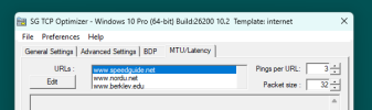

6. Click on the MTU/ :atency tab at the top.
Use the down arrow select the slot in the suggested sites you might try. I go to the bottom then click on edit and put the URL in the box and click OK
7. OK all done and ready to go. Click on Largest MTU at the bottom and watch the test results
