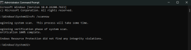

In the years I have used windows more as a convenient gaming experience and programming platform than anything I have never ever seen this NEEDING TO BE DONE, they mess things up and spend millions on programmers fresh out of college to do the updating and they havent got half a clue what they doing. Anyhow this has been on my windows update screen now for 2 weeks and so far i have run
SFC /SCANNOW
There own check tool says theres nothing wrong with the system.
So.................
System File Checker (sfc) is not intended to tell you that there's nothing wrong with the system, only that none of the system files are missing or corrupted (and replace any that are). If you are having a recurring issue installing updates, an in-place upgrade is probably your best option. No settings or installed programs will be affected:
